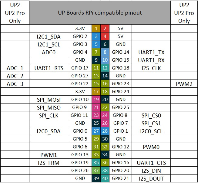

I have a button wired between physical pin 15 (GPIO6) and physical pin 14 (GND) on the 40-pin HAT. I've confirmed with a multimeter that the wiring is correct — the pin reads 3.3V normally and drops to 0V when I press the button or short it to GND with a jumper wire. So electrically everything is working perfectly.

For reference, here is what I have already tried:
  • BIOS set to Input for GPIO6 ✓
  • Multimeter confirms pin voltage changes on button press ✓
  • Tested with both read and irq commands in UpNetGpioTestTool ✓
  • Tried SharedReadOnly and Exclusive pin sharing modes in code ✓
  • Clean reinstall of UP Framework V24.09.10 ✓
  • Running as Administrator ✓
