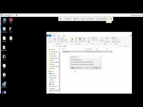

Using UNLOCKER I was able to get the fact that the file was locked as a service, but that's all, even UNLOCKER could not delete it. I had to boot my pc to Ubuntu on a stick and mount the filesystem and delete from there.
Ill grab a clip in a minute from my other PC.
https://www.youtube.com/watch?v=qR5f-yq5PPs
again as per first post, it created a folder called ipch with subfolder DIO-4f1f0326, containing a file DIO-a29a96a2.ipch, 75mb in size. Deleting this folder only resulted in it being recreated at some point after. -
