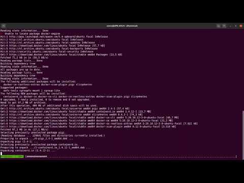

    I have to say trying to get the Hailo working with the UpSquared6000 has been VERY unsuccessful. I have wasted many hours on it. Perhaps step back to the beginning. This page says to use 20.04.4
    https://github.com/up-board/up-community/wiki/Ubuntu_20.04.4 and all of the rest of the Hailo install seems to assume this. And indeed this is what is referred to in the getting started with Hailo video
    https://www.youtube.com/watch?v=ookjOPzhIxc
    BUT this page says if you have an Up Sqaured 6000 you should use the intel-iot version
    If you do the latter you get 5.13 kernel - I can't seem to make that work with hailo.
    So please clarify with that WHICH VERSION OF LINUX on the UpSqaured6000 if you want to use Hailo would be an excellent start.
