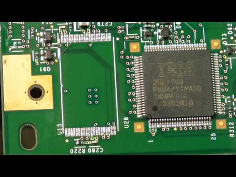

Anyway: I think cutting just the power supply to the RF chip is going to be very difficult, especially if you do not have the right equipment.
I think your best option would probably be to just remove the entire chip if you are certain that you will not need it anymore.
It's not that complicated, you pretty much just need a hot air gun and some tweezers:
https://www.youtube.com/watch?v=os0WczN5iIAI'm sure you know this, but I'll just mention it anyway: If something goes wrong you could destroy your board and everything you do is at your own risk, of course.
