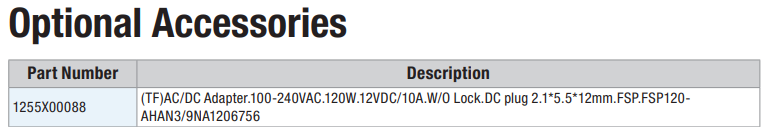

    You actually might be onto something. I was able to find the specs for my power adapter. It's capability is 3-12 V @ 0-2 A. The specs for the computer suggest typical consumption is 30-36 W.
    12 V @ 2 A means a max of 24 W. I'll get a new adapter and try it as soon as I am able (early-mid next week).

    A higher power supply is required; please refer to our datasheet.
    We recommend using a 12V / 10A power supply.
    No need to modify BIOS settings.
