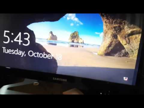

The screen glitches to scanlines randomly , directly on boot, in the boot sequence or in windows itself. every now and then it wont glitch at all..

if a picture is worth a thousand words I guess a video is worth a million?
https://www.youtube.com/watch?v=d9cIk-gW288
https://www.youtube.com/watch?v=d9cIk-gW288Ive had the UP for a week. Will you replace the unit?

If anyone needs to know, scanline crash fixed, i turfed the power supply that shipped to me and replaced it with a beefier one, scanline issues resolved at least.
