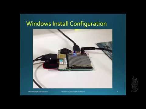

Just wanted to share that I was successful in using the UP provided "overall" information to install Windows 10 (1067) on my recently received UP board (64 GB version). Windows 10 used about 12.3 GB of the board's eMMC.

I just posted a video on YouTube using pictures taken with my cell phone, so some were not great, but I think that I got the install process described accurately enough now for you (
https://youtu.be/fIhT61Vlq-M), Hopefully this is of use to you.

I did not do anything special. I had prepared my USB stick as per UP instructions, inserted it in the UP board as received from the UP company, hooked up all display, keyboard and mouse, and then just powered up the system, and then the UP board booted up from the USB stick and started to install Windows 10 as shown in my YouTube video.
