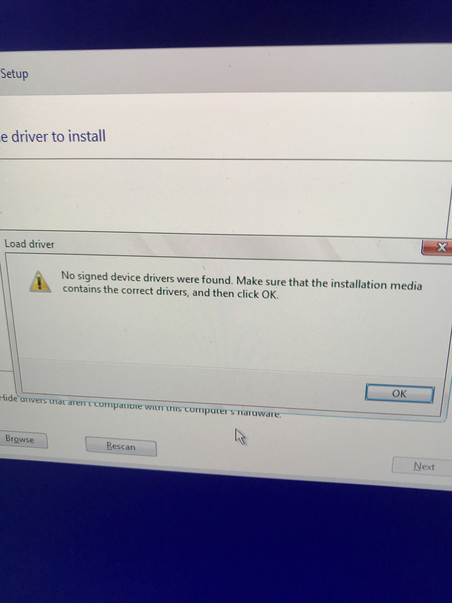

I got the above message when trying to install on that USB

Thanks a lot for your help so far. I took all the steps using Rufus and when trying to load from USB this time I get the error above
it seems you are missing the efi boot loader. It should be explained in the documentation, but after checking they are suggesting something wrong.
"At the next screen, you'll need to determine your destination disk. Open the drop-down menu and choose your USB drive. A message pops up asking you to select a partition scheme. Click the MBR for BIOS option and hit Yes."
You should instead select GPT for EFI.
Try again with that option and let me know -
With MBR option I still get error as attached
