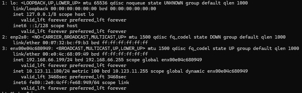

    However we found an issue with the bios updates as they seem to kill the ethernet on board. It is no longer able to get into an UP state.
    An external USB Ethenet adapter works fine however.
    ip a:
    There has nothing changed but the BIOS update to UPAPBM11 downloaded from the support page.
