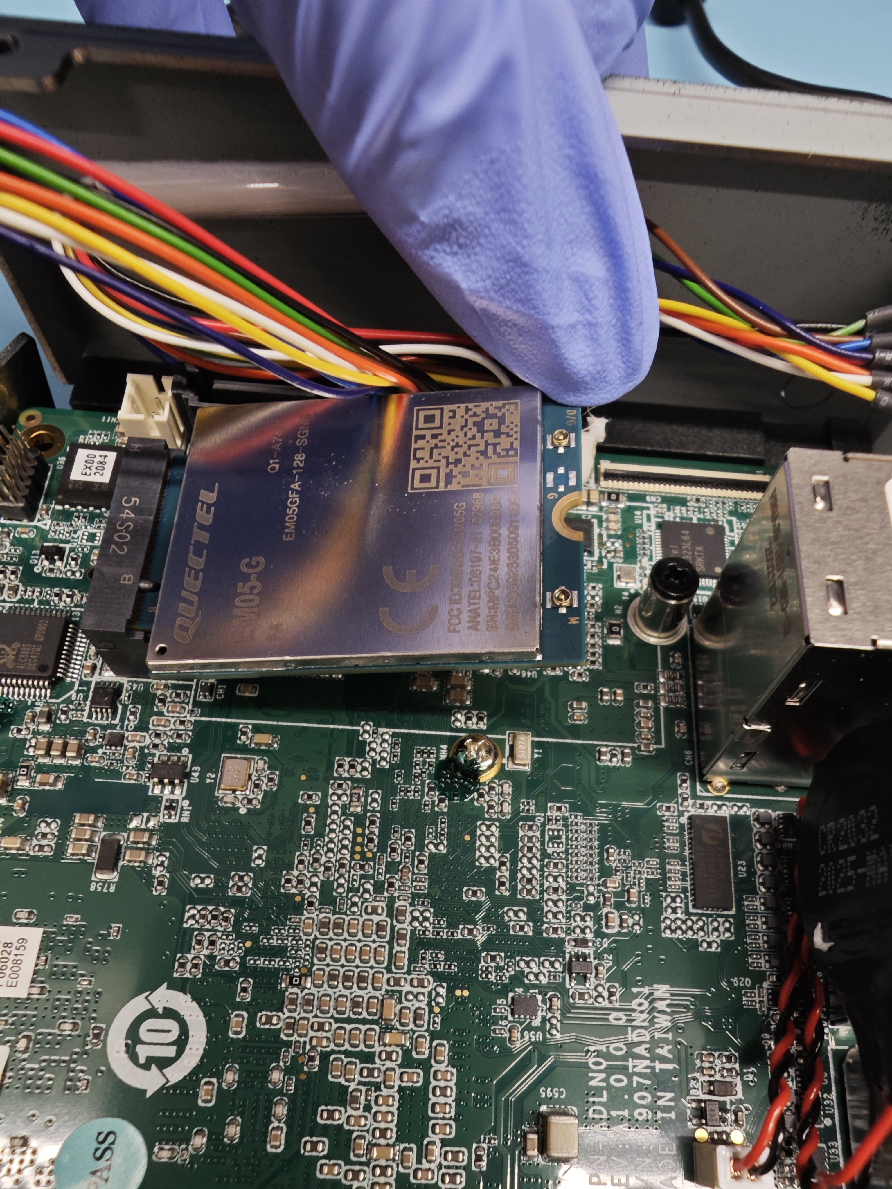

When we installed the EM05 module into the system we find that the PCB standoff on which to screw down the module is too far to reach. I've attached a picture here:
Wondering if this issue is recognised and if there's a readily-available fix before we attempt a custom DIY job.

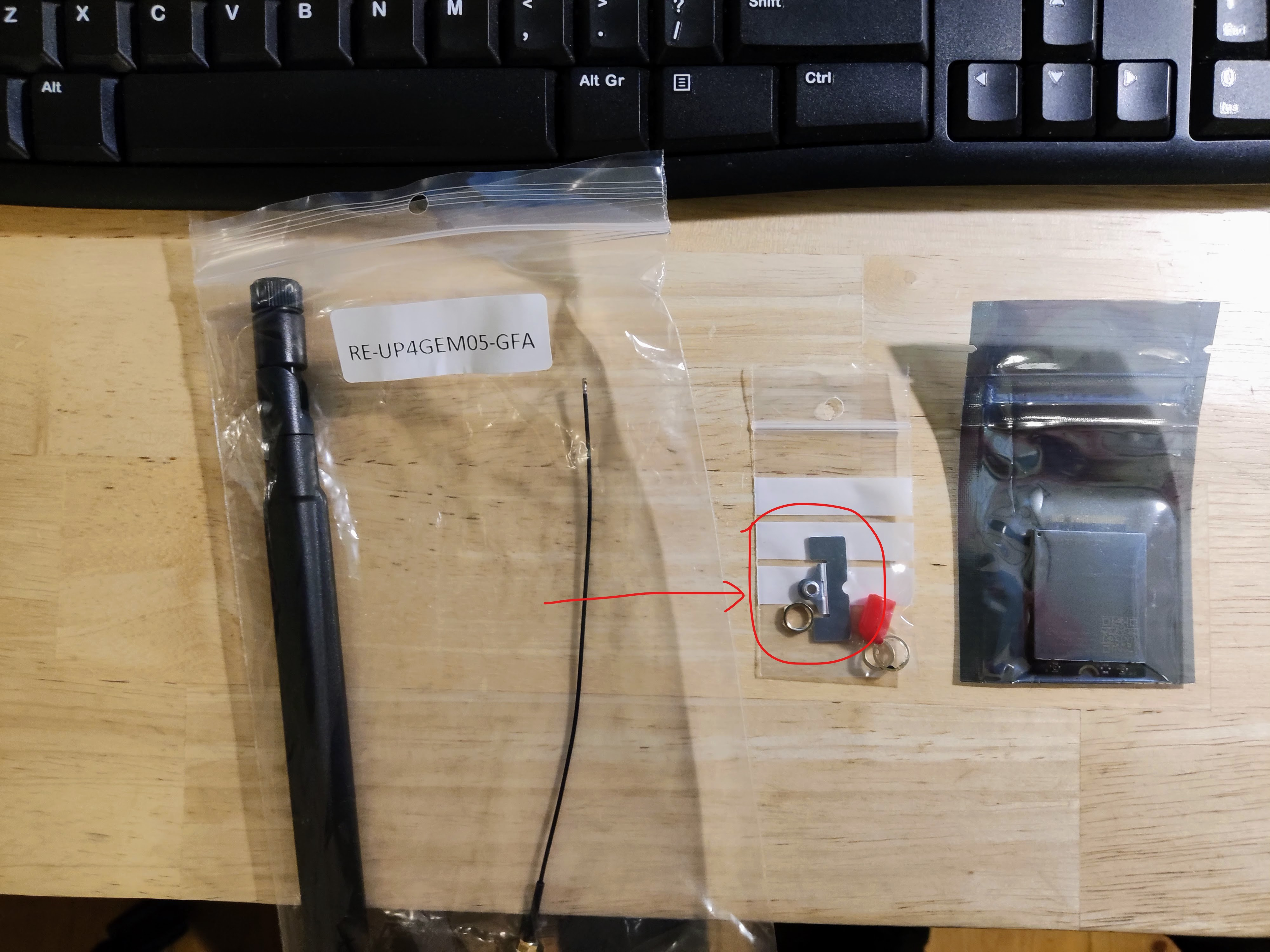

    We found the solution to this in the end - it turns out that the Quectel wireless module package comes with a little extender for exactly this purpose. We failed to notice this in the package, but now we know. Should have read the manual.
