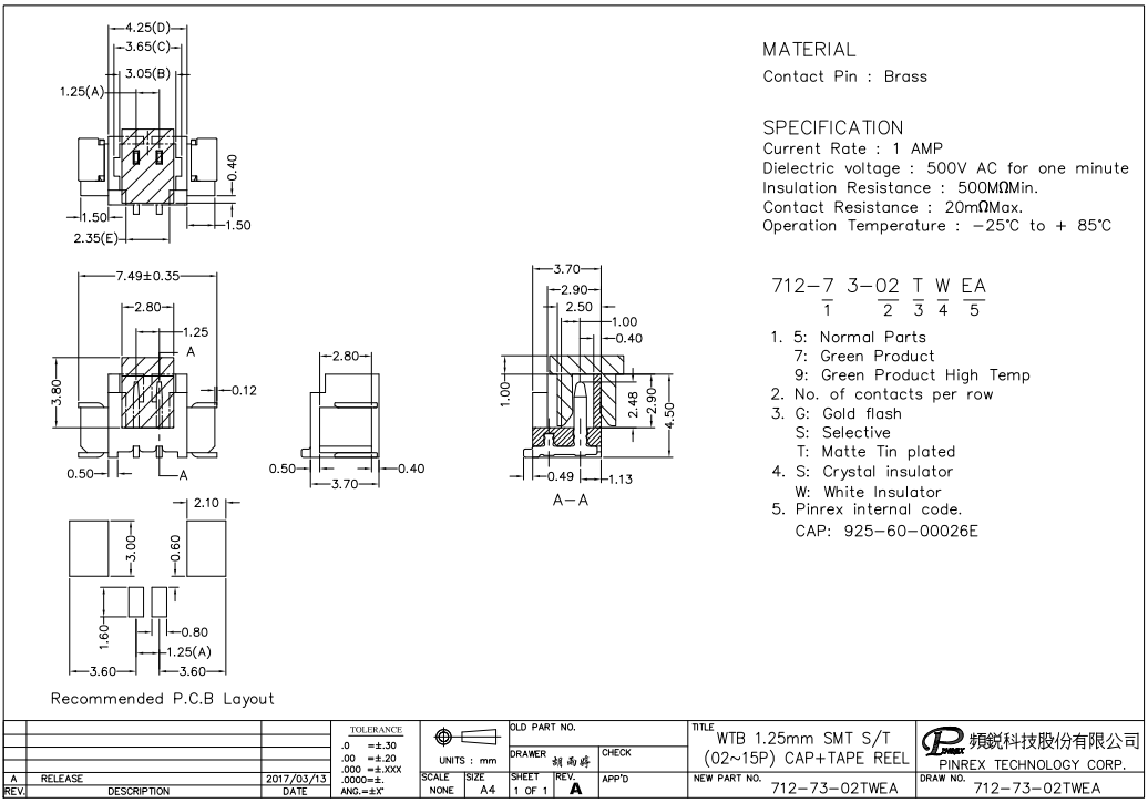

hi, which is the fan connector MFR code for up 7000 board connector CN11?
BR -
Hi @robit
CN11 part number is 1655802020.
You can also find this information in the user manual.
https://www.aaeon.com/tw/product/detail/up-7000-boards/downloadSpec of CN11
