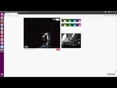

Found a video demo of the tiny UP Core and a RealSense camera:
https://youtu.be/Khq92ZryEI8Eric Duncan - UP Evangelist - My thoughts are of my own free will
